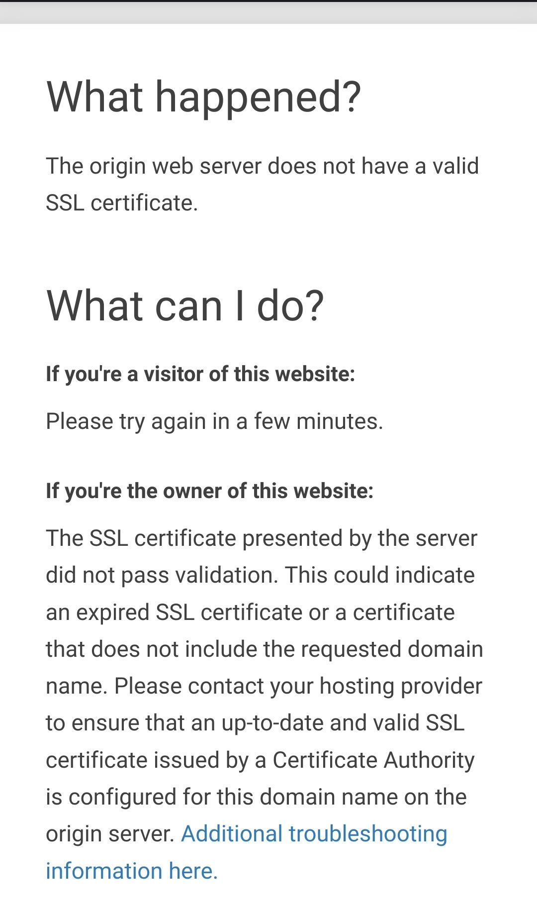

    @phenomlab i think i missed this step, how can i make sure i am using NGINX
    my current settings for ask8
    ask8 is not opening because i have opted for HSTS i want an origin server certificate 🙂
  • @phenomlab i think i missed this step, how can i make sure i am using NGINX
    @Hari How did you install Virtualmin on that droplet ? If you used the default commands, it is using Apache.
