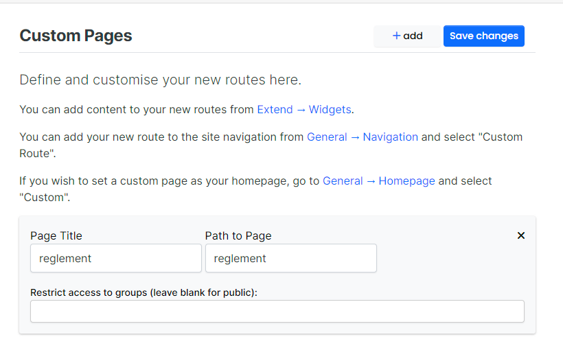

  • Hi I am trying to create a custom page called GameTracker. I head to Navigation and add a custom route. Do i type /gametracker or gametracket.tpl in the route. ? To be honest none of them work. When I go to extend/widgets I do not see the template. I have uninstalled and reinstalled but with same problem. Nothing in logs what I can see. What am I doing wrong. I did this in the past no worries. Many of these older plugins to not install at all for me in the ACP. I get a huge error. Now I cannot even uninstall it without error.
    I tried to gove nodebb the benefit of the doubt. I had new OS install, new mongo blah blah blah but soon as I touch this nodebb its a nightmare lol.
    I also did not have this below on my page. Maybe thats an older version. Someone was mentioning this here in Sudonix some time ago.

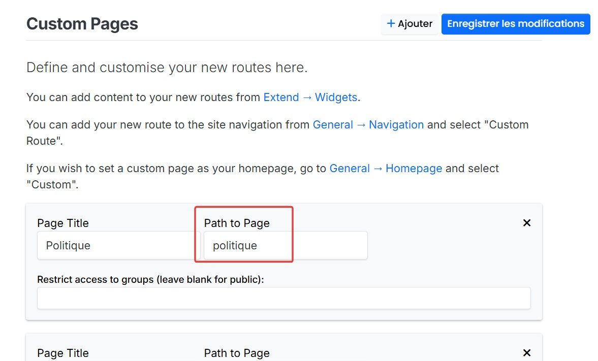

  • Personally, I don’t use custom routes in navigation. I put the link in a classic HTML href to access the page in an HTML menu of the BrandHeader, then I use the widget to generate the HTML for the page itself.
    Seems you have problem with npm for uninstall the plugin in your screeshot
