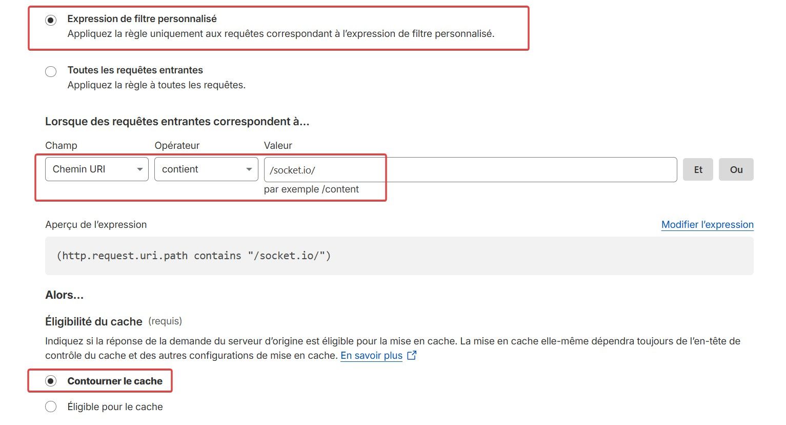

    ### Cache Rules
    - Rules created:
        - If URI Path contains `/socket.io/`
        - Then: Bypass cache

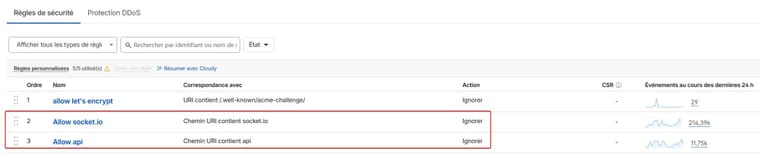

    ### WAF
    - Custom ignore rule for `/socket.io/*`
    - Custom ignore rule for `/api/*`
    No rate limiting.

    ### Cache Rules
    - Rules created:
    ### WAF
    No rate limiting.
