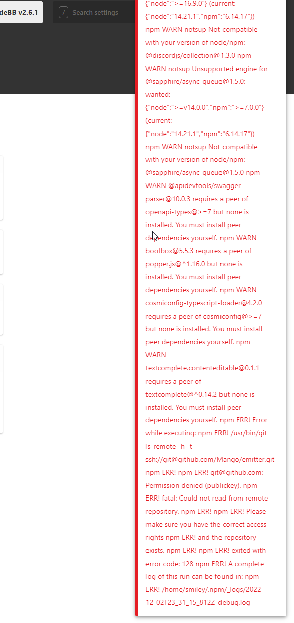

    All broken at the moment. Will figure it out 🙂 Using that guide above stopped my other app and a ton of errors on install 🙂 Also this is now in nodebb. All for another day 🙂
    @Sampo2910 what were the errors? I’ve never had an issue with it?
  • @Sampo2910 what were the errors? I’ve never had an issue with it?

    @Sampo2910 yes, that does indeed look a mess! I don’t think nodeJS at version 12 for NodeBB is even supported anymore. I asked a similar question but so long ago
    https://community.nodebb.org/topic/16532/supported-version-of-nodejs
    Plus, the version of MongoDB started (3.x) is also really old. I seem to recall you using an app which is considered legacy and requires older versions of software, but I think the two together are going to cause you significant issues - clearly which you’re seeing now.
    My suggestion would be to keep these on separate machines.
  • @phenomlab Only way all works is if i use node v12 anything more i get errors like that on the page.
    MongoDB shell version v5.0.14 and MongoDB server version: 3.6.8 is what I am using. I get a warning that they do not match but i cant seem to update mongo server version either.
    I am not at a level where I understand to be honest. Node, npm, nvm mongo…things work on some versions and not others. Updating to the latest just breaks things.
