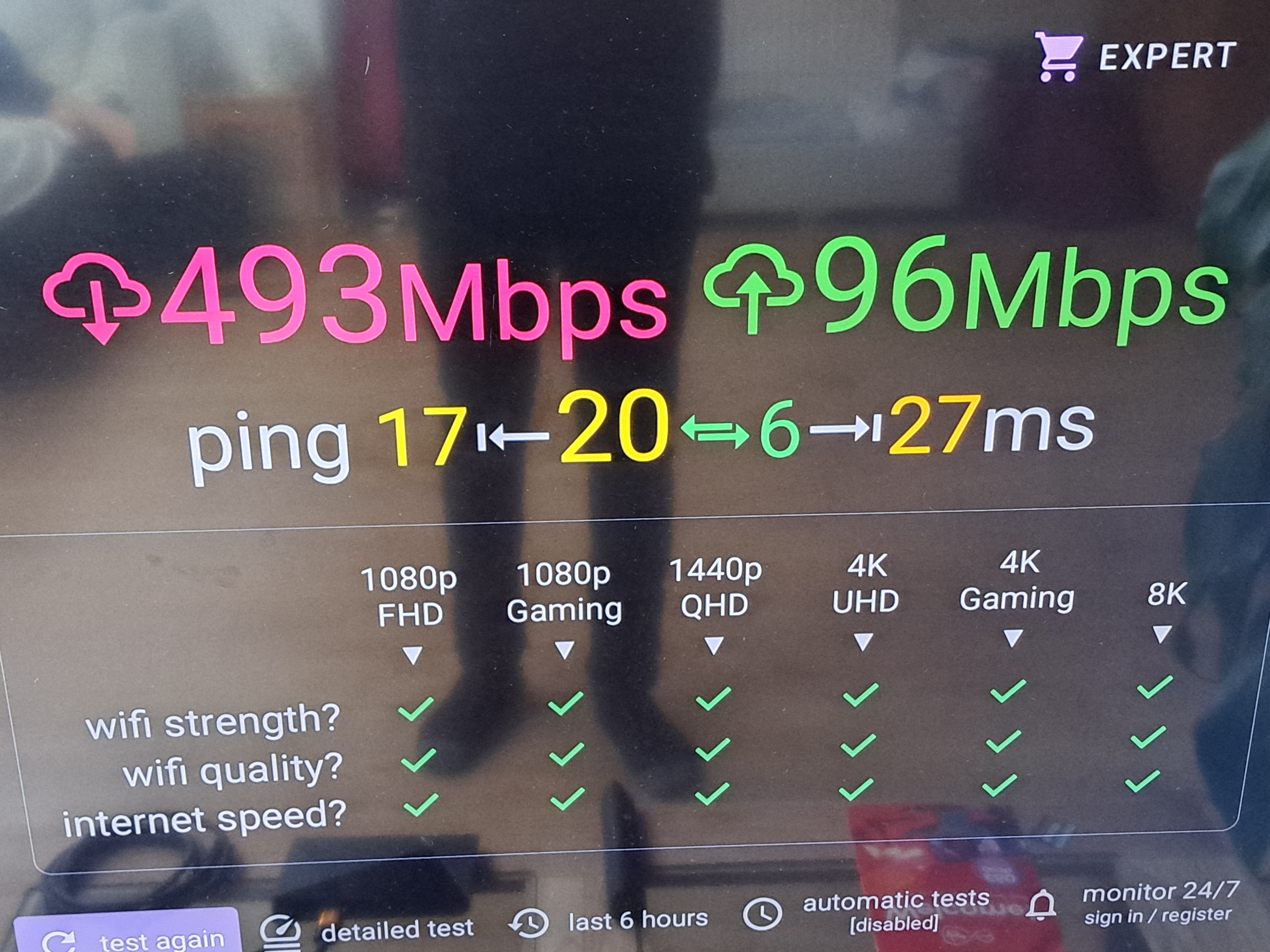

    The test was also ran in the same room upstairs where the shield is. 😃
    #67
    @JAC Those are in fact good speeds, but I’m sure we can do better with the Archer.
  • @JAC Those are in fact good speeds, but I’m sure we can do better with the Archer.
    #68
    @phenomlab I agree yes, the speed is great. I wonder why I only see speeds of around 100mbps or less on the Nvidia Shield 🧐
